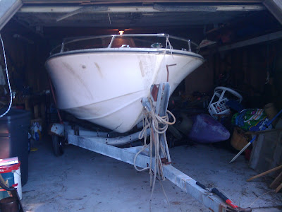

Hey folks, my name is Sam, and this thread is going to serve as a journal for my first boat project. About a month ago I got a free 10' aluminium jon boat that my father had found washed up on shore. I was planning on rebuilding it, and was surfing craigslist.org for a trolling motor when I came across a listing for two free boats, one was a 22 footer, and one was a 19' sea ray. I contacted the poster, and went to see the boats. The 22' was in pretty rough shape, but the sea ray was in nice shape, no motor or anything, but the hull was in nice shape. He told me the boat was free, but he was hoping to get $250 for the trailer. I asked if he'd mind $125 a week and he agreed. Two weeks later I picked up me boat! I'l update again a bit later tonight with pictures of the move and what I've found so far.
Just to tease you a bit, here's a picture of the boat just barely fitting in the garage.
Here's a link incase the pic doesn't work.. Clicky

Consider removing the cap. From what I've seen it makes things MUCH easier than working around it. Also a 90 HP is going to be barely adequate for that size boat. That thing would probably take 150-200HP easy. What type of boat is this? open bow, cuddy, closed bow?

The front view looks kinda like oops! boat so I think it's an older closed bow. Once you have the cap off and the floor up you may as well do all the stringers and it'll probably need a transom as well. 1 month do do the rebuild is very optimistic, I'd make it a winter project. You will be disappointed with a 90 on the back for sure, way underpowered. Here's a good thread for you to read, it's long but has most of the info you'll need and it's a great story.http://forums.iboats.com/showthread.php?t=234392
