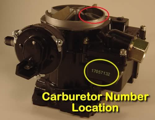

Now when I put the carb back on the motor and pump some fuel to it from the old electric fuel pump (because I'm having other issues with the mechanical pump), it just pours out from the top of the carb (see pic) and through the two venturis (not sure on the terms here). It seems like the float is sticking right? But it's all clean and new. Maybe I will have to adjust it so that it closes at a lower float height? What else may I have missed?
Red circle is one of the spots that fuel is pouring out, the other spots are down inside the throat.

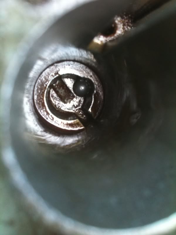

As far as the check ball goes, below is a picture of the little ball that is inside the pump well. Again, I tried to get it out with absolutely no luck. It doesn't budge. The carb kit sheet shows that if there is a ball that goes there, then there is also a retainer clip. I don't see a clip, unless that is the ring looking thing at the bottom just above the ball? It feels as though that piece is made into the carb and doesn't move.
The two different valves... one on the left is the type that I took out originally, on the right is the one that came in the kit.
Is this the checkball in question? If so, any tips as to how to get it out?
