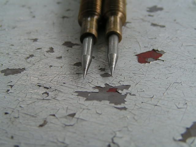

Bought a boat with a 1971 50hp. It ran but didn't idle the best. I've done a laundry list to this so here it is I rebuilt the carbs, added a tach, new throttle cable, new impeller, and changed the lower unit fluid.
1. For the new cable it with the controls in neutral and the throttle against the stop pictured if the trunion goes in it should be adjusted right correct?
2. Per the manual I set the low speed needles to ~5/8 turn out. It will run if I use the warm up lever and if I adjust #1 in just a bit it will smooth out enough to bring the warm up bar down just a bit but I can't ever get it down to an actual idle to do anymore adjusting with out it sputtering and dieing.
3. Don't know if it might be connected but my new tach isn't working. Per the instructions I ran a wire (no wire in the factory loom) from the yellow to the send pole on the tach. I have it set at the 6P mark. The instructions said any yellow so I even tried it on the other leg (yellow/grey) and still nothing.
I can get a video of it running if it will help.
