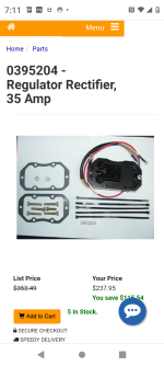

I would like to test and possibly replace the rectifier. This seems to be the correct part, but I'm having trouble figuring out where that part actually is on the motor.
I can see the rectifier on this diagram, but I just don't really understand where it is in relation to the overall motor...

For models with trim and tilt. Test yours first with a multimeter.....easy to do.

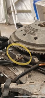

Attached are four more photos of the motor. I do see some orange wires, but I still can't seem to locate the rectifier itself.
Any help would be appreciated.

As I stated earlier it is clearly visible , partially under the flywheel.----In the 4th picyure !!
