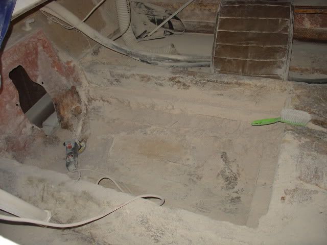

Finally got the tank out. It is a 34gal tank and was full of fuel. I wasn't sure how long the fuel was sitting there, but I didn't want to use it my truck. So I put ad on craigslist for '34gals of free fuel. In the Pheonix metro area only 6 people called about it.
I have the 90% of the floor ripped out and grinding is under way.
I plan re-using the foam stringers but re-glassing them.
I still have to remove some of the deck plywood that is under the bow's sub-deck, but I do not want to remove the cap.

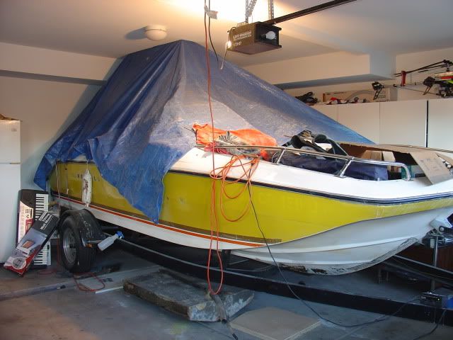

I live in town now with HOA in my neighborhood so all work has to done in my garage with main door closed. This has slowed progress down big time.
I miss my barn in the country.
I have constructed a tent over the boat to 'try' and keep the dust from getting everywhere.

i just saw your tent......MAKE SURE you have GREAT safety equipment for grinding......read safety basics for grinding and glassing...it is a stickey.....that is the minimum...
i just posted more about safety equipment in my hull thread,,,,just click the last page bud

Just read your post about the safety equipment. I put as much on as possible. but the with heat already on the rise here I need to get all my grinding done quick. The towel around your head in a good idea, but it would hold a lot of sweat. LOL
I only use the flap disks on my grinder, I have had a bad experience in the past with a solid disk breaking off. I use my multipurpose tool wherever possible, to cut down on the amount of grinding. But the fiberglass just eats those blades up.
Hopefully all the removal work will be finished by next weekend, so I can move to sanding and cleaning.
I don't want to rush this, but I want to do my glassing before it gets too hot and the resins working time is reduced.

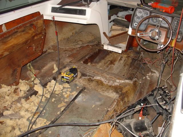

Finally got all the old fiberglass and wood out of the hull.
One question, the foam core of the stringer system has come detached from the hull in places. Does this need to be secured back to the hull before I glass over it? If so, what is the best way of doing this? 75% of the system is still attached.
Thanks
Yacht Dr.
Feb 26, 2005
5,581
Re: Reinell Foam stringers repair/replace?
From what I see/understand of the pics..you should be fine with removing bad/delaminated tabbing..and retab the stringers.
YD.

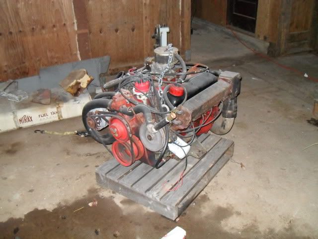

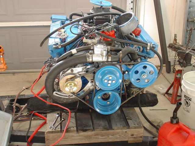

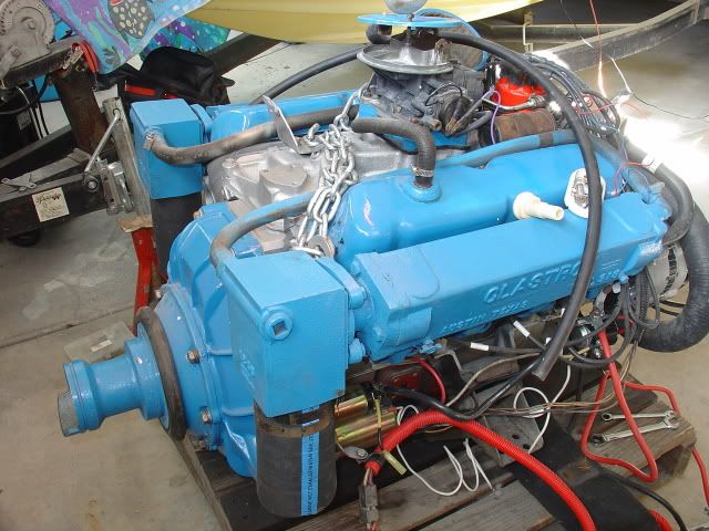

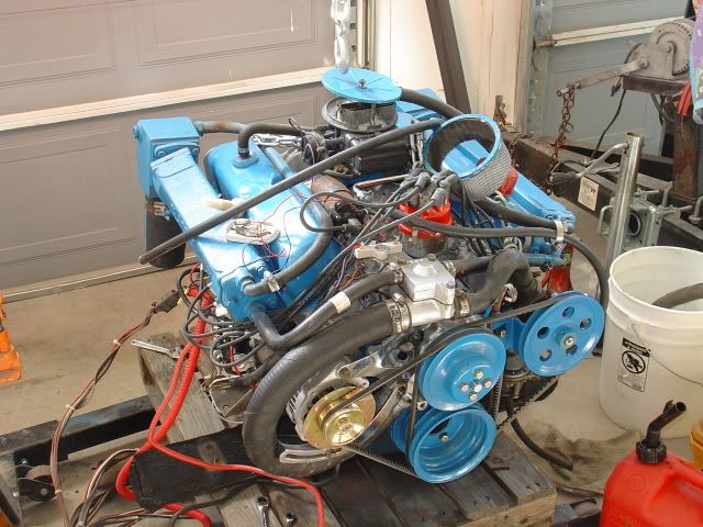

I took a break from the fiberglassing work, and started work on the replacement engine for the Reinell.
Before
After
Replaced the starter, alternator, raw waterpump, timing chain and put new gaskets on.
And painted it good old Ford Blue and aluminum
Only thing let to do is fit a Pertronix setup.
Just I thought I would share ;)

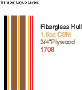

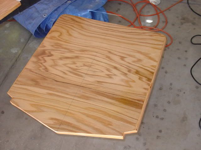

Finally got round to finishing up the transom ready to be bonded to the hull.
I used two pieces of 3/4" ext. grade plywood that has been drying in my garage with the nice dry Arizona air helping :)
I encased the joining surfaces of the plywood with two layers of poly resin then bonded them together with poly resin and one layer of 1.5oz CSM.
Next the transom was shaped/contoured to allow for a perfect fit and easy filleting and tabbing.
Then all of the exterior of the transom piece was sealed with two coats of poly resin.
It is now ready to be bonded to the hull.
Layers of the transom
Here is my transom bonding plan:
1. Put one layer of 1.5oz CSM on the inner hull
2. Peanut butter Poly resin on transom plywood piece
3. Fill and fillet
4. After fully cured, tab with CSM
5. Cover complete transom with CSM
6. Tab again with 1708
5. Cover complete transom with two layers of 1708
Does my plan sound about right or it is it overkill?
