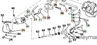

That went very well ! Was surprised it lined back up as well as it did. I knew I had rotated the rod/dog leg and was anticipating a headache getting it latched back in. Lined right up !
Started it to check the new water pump impeller and when I pushed the key in to choke it, fuel was seeping out around the base of the red knob. Is this a manual override ?
Or a bleeder ? There is a Schrader valve in it ..... what is the NOP for this guy ?
Looks like I just need to change the O-ring (53) to stop the leak, but am wondering about the rest of its intended operation.
Thanks

The red lever is for manual operation of the valve should you have a dead battery.-----Yes this motor will start / run with a dead battery.-----The shreader valve allows you to inject engine tuner or storage oil while motor s running.

Now it turns from seated closed to about 90 degrees open.
I assume there are stop lugs for the red plastic lever underneath .... which is split on one side. Do I splay the plastic to get it off ? and the valve out ? Or does it slide off ?
Quite tight, doesn't want to slide and I don't want to break it ... being so old (not me, the red part)
Thanks again !

Get yourself a rebuild kit for the primer.
It will be pretty much self explanatory from there.

just buy an OEM brp/ nos kit, not that really cheap crap! Sierra works well, too. you have been warned.
