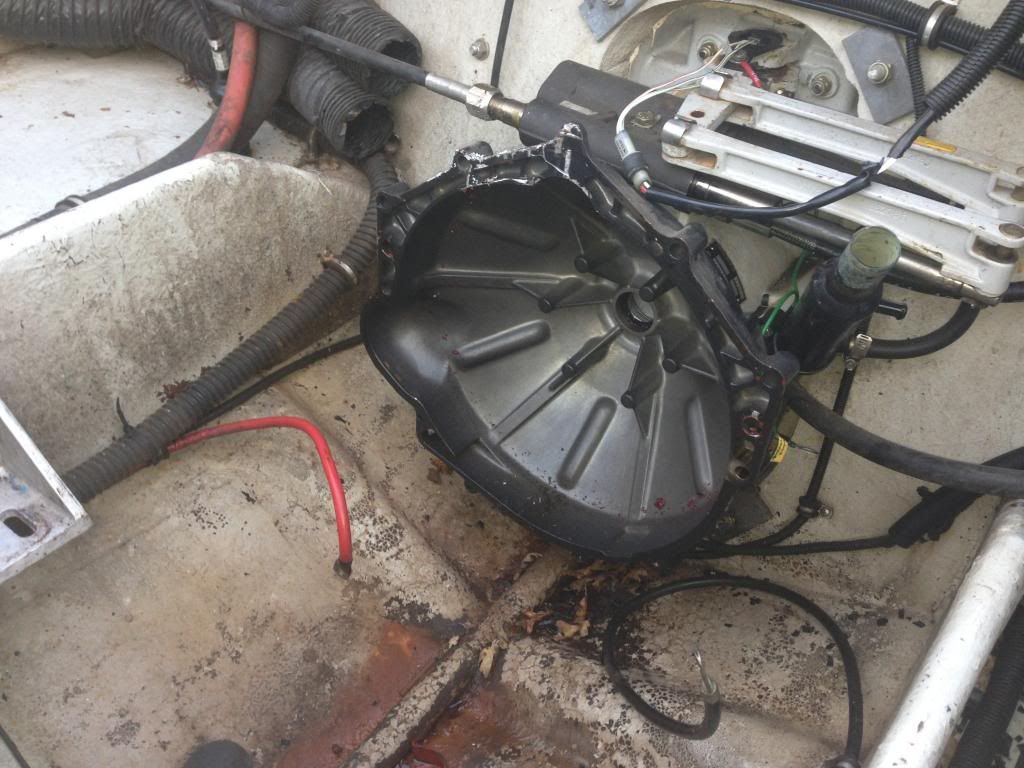

Pulled the engine today without the housing. I don't see how this is possible with the housing attached because I had to rotate engine 180 degrees to get it to clear the hatch. Scuffed up the housing a little bit but overall it went pretty smooth. Here are some pics of the housing. After searching a bit it seems that the red housings are the double bearing configuration with a zerk fitting for maintenance. I do not have a zerk fitting anywhere on the housing. Can somebody please confirm that this housing is correct for the 5.7 liter and not just a Frankenstein package done by previous owner? Thank you for your time.

Re: Remove the engine with or without intermediate shaft housing?
Looks like you proved all of us wrong.
What year?
50,261
it looks like a later PDS assembly. couldnt tell you what it is from.

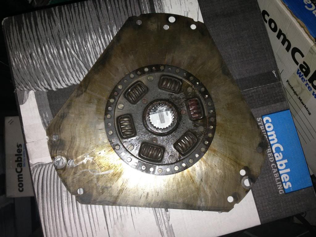

So I have been searching for a replacement flex-plate/dampener and some of the pictures I see it looks like the springs are covered. Seems like the plates that have the covered springs might be a better idea to minimize the rattle like the sound I was experiencing. The sad thing is I don't see anything wrong with the part I removed. Can someone confirm which dampener I need?
Here is the dampener that came off my engine.
