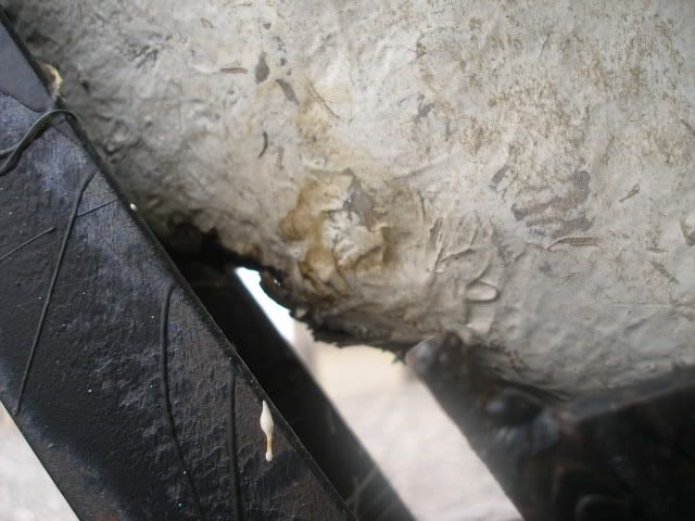

Now for the problems, When we were loading her on the trailer, the previous owner didn't quite get her lined up right and banged up her bow:
before this, no water was in the center bilge area, now there's a slow leak, bilge pump handles it fine. Then, sometime after I put her in the river, I must have banged her on some rocks because I found this area when I pulled her out in early November, approximately 4 to 5 feet back from the first ding in bow.

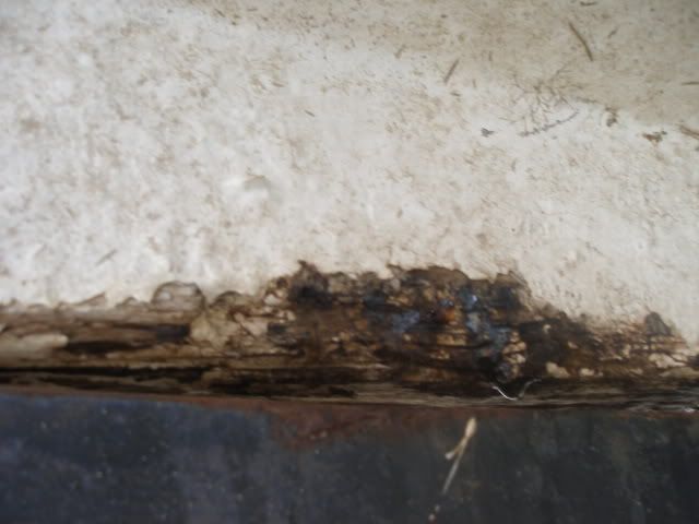

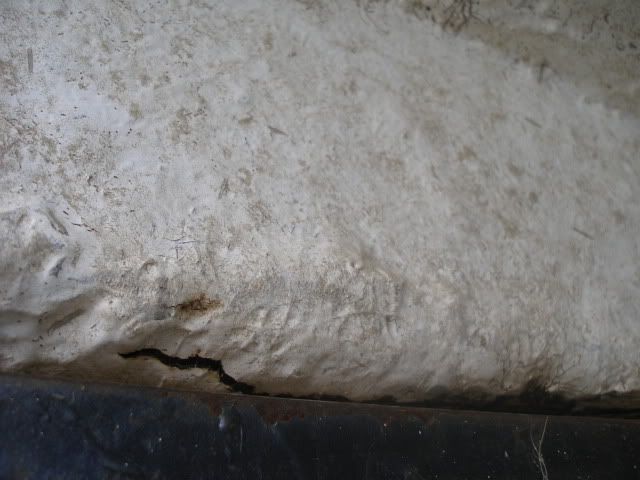

There appears to be some cracking of the fiberglass in front of that:
Guess I should mention that the hull was covered in 3 layers of glass toped with a rhino lining type spray on layer.
From reading here, I know a good repair is made from the outside and the inside, I can't do that here as there is no access from the inside.

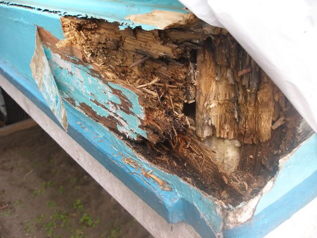

Also when I pulled the boat out of the water, noticed that there appeared to be a bad spot on the port stern area. I got hit in that area while on the water about a month before.

OUCH! that last pic is going to be a tricky repair. first it shows that the transom and probably all the stringers have seen some serious water damage, and will need replacing/repairing, but fixing the hull up around that hole is going to be tricky aswell. You will probably need to make a mold around it, then layup that section of the hull from scratch again. Is the boat wood hull? if so lets hope the rot hasnt spread too far yet... Check out the hull extension thread for an example of molding the hull section
http://forums.iboats.com/showthread.php?t=234392
It also looks like it has created some pretty serious cracks all the way down the hull too.
I hate to be the bearer of bad news:(
on the good side, nothing in impossible, just a lot of time... the guys on here can take you through the entire repair step by step...:)

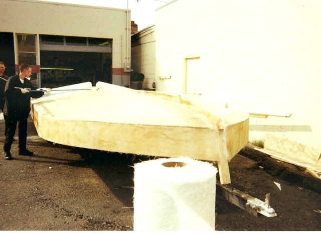

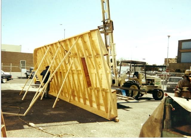

Here's a pict of the hull while it was being built, the damaged area is right on the keel (at least I think that's what it's called)
And yep, the boat is wooden, I'm told he used 3/4 inch marine plywood with 3 layers of glass and one layer of Rhino Liner. The picture above is while the glass was being done.

The stern damaged area, about 1.5 feet from the corner, the wood is not rotted. It only appears to be that immediate corner area.

From the looks of it, the gentleman that made it used the wrong resin and wrong type of glass, not what you wanted to here, just the way it is.
He should have used epoxy on the wood, it bonds much better, plus he should have used a woven and/or stitched (continuous strand) product instead of mat. Had he done these two things there would be little or no damage from the cracked laminate and less chance of rotten wood.
The good part is the fiberglass is easy to fix, the bad part is the wood will be difficult to fix if the rot continues further into the structure.
Time to start digging and see how much is rotten.

HAHAha sorry Kaye, what i meant was move forward a foot of two and take a core sample , but i think ondarvr is right you need to tear in to it farther, and see , i really hate to say it but she is a mess and going to take a heck of a lot of work !!! John

Okay John, I did that, to the left of all the rot on the stern the wood is good. I've been reading here alot and wonder if the stuff that Donnyskz1 used on his transom repair might work here? He used something called nida-bond. Nowhere on their site did I see what it would or would not bond too, anyone know? Am thinking if I can remove all of the rotted wood, then build a barrier on the inside and outside and pour this stuff is that a locial way to go??

John, do you think that Marine Tex might be an option on the bow and keel? Have been reading your comments on other threads about it. If I take a dremel and grind out and rough up the exisiting glass and wood in those areas? Maybe????

problem with your dings is that wood is exposed. some of it looks pretty dark too. slapping a patch over it will just hide the problem. each spot will need to be checked for the extent of rot. that will decide how you need to attack the repairs.
the transom corner doesn't look fun. you can see the glass delaminating and peeling back in a sheet. how far does that crack run?

Salty97 - I pulled the glass away form that area so I could see how bad it was. It really wasn't all that easy to rip away. Area affected appears to be less than 1.5 feet.

The nidacore is very thin, and requires molding, it is usually used for the transom of fibreglass boats where there is a layer of fibreglass on each side of the wood, grind the wood out and the fibreglass acts as the mold for the nida-core or seacast. You only have a bad external layer of fibreglass, and as far as i can tell no layer on the inside. I would start by ripping up the floor above the damage and seeing how far it goes. Then if it were me i would make a clean cut and cut all the damage out and reconstruct that corner from scratch with wood, followed by afew layers of glass on the outside. You wil also want to repeat this proccess over all the other damaged areas. You want to seal all the wood from the water as best as you can. Rotten will will just keep going and getting worse until you isolate it. Just adding more wood to the damage will work for a season or 2, then it will be all rotten aswell. you have to get rid of the rot and start with fresh wood.
Once all the rotten wood is dealt with i would cover the entire hull in a layer or 2 of roven or biax cloth, this will give it strength aswell as keep the water out. Yes the cloth will probably be expensive to cover the entire hull. but that would be the correct way to do it. The hull will also need a bit of prep to prepare it for the new cloth.
others may have other idea's, but that is what i would do.

What sort of access do you have to the inside of those other damaged area's? the one on the bottom of the keel may be hard to do anything other then just resealing the outside with fibreglass and hope its not too bad. Seeing as the keel is the center of support for the boat, and with only one layer of mat on the external the boat wont hold together if you start cutting the keel out. cant really see the extent of the bow damage. maybe afew more pic's would help.
