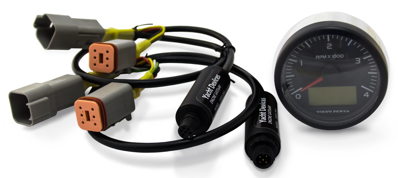

Hi. You need the Volvo Penta easy connect or gateway. This will allow interface between compatible plotter screens and the engine data.
