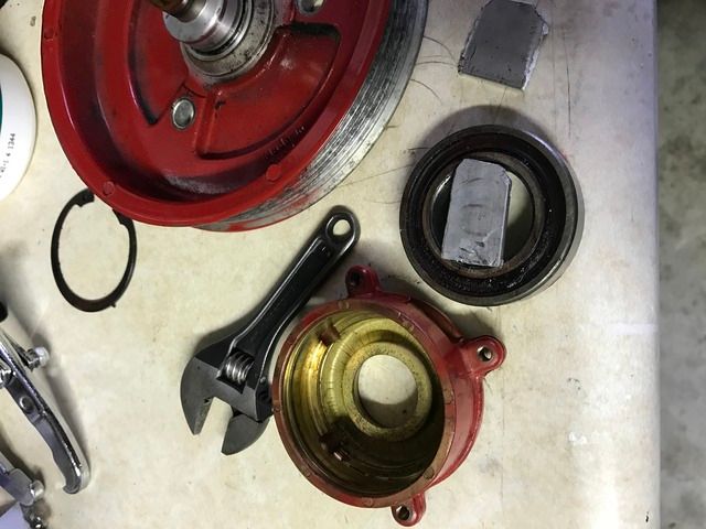

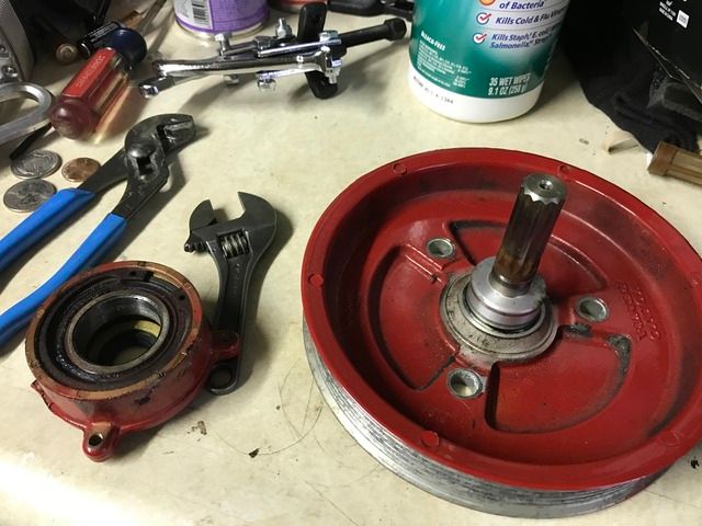

A 2 jaw puller made quick work of the bearing housing:
Then I cut a small piece of aluminum that I had to slide into the bearing. Using a socket I pressed the old bearing out in a vice. Ive seen photos where someone used two allen wrenches. They insert the short ends back to back in the bearing and use those to press it out. I had not seen that before I did this but someone else may be able to use that method.
Used the old bearing to press the new bearing in... Vice made quick work of that.

The kit came with some loctite that I placed around the bearing before pressing the new bearing in and also around the shaft when I pressed the bearing housing back on. I placed the pulley and bearing housing in the vice to press the housing back on the pulley. Used thick shop towels so as to not damage the brass and pulley along with a large socket that went over the pulley shaft...
So far so leaks! Ive ran it on the water hose for a good bit... We'll see if it makes it through the season! Now to get figure out this belt squeak!
