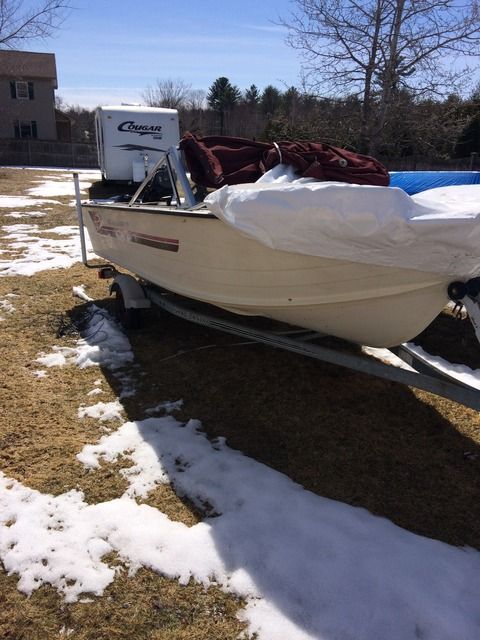

I introduced myself a while back, after purchasing a 1982 160SS that I found on the local CL listings. The boat came equipped with a Merc 80hp, that I had no idea if it ran or not. The package was neatly nestled on a Shorelander galvanized trailer, in decent shape (minus I light and a flat tire). The hull of the boat was in great shape, no dings, dents, huge scratches, etc. I took a risk on the motor status, and paid &750 for the whole deal, all nicely shrink wrapped for the remainder of the winter. My intent is to convert this into a duck boat, so the "finish" won't be as pretty as some others here.
Recent uncovering
I took a look at it all on a nice spring day, a few weeks ago, but waited until this weekend to get it out and start the process. I started with seeing if the motor would run. Not fully trusting the PO, I had reservations about what to expect. To my surprise, I found some newer parts under the covers. Including some pricey electronic parts, and some wiring harnesses. Not all of it, but enough to tell me somebody put some money into the motor. The PO gave me a water pump kit, so before trying to make things happen, I swapped out the impeller, and a couple seals. Didn't want water issues out of the gate, if it started. Little frustration getting the LU back into place, but eventually the task was complete. To my delight, the old 80 came to life, surprisingly easily. Took a few minutes to warm up and run without any throttle, but it was all a good sign. That was all Sunday

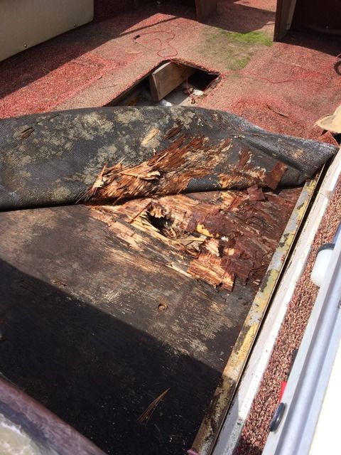

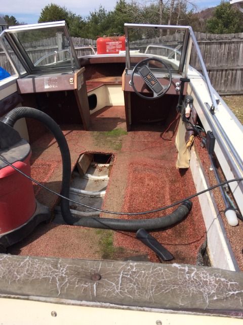

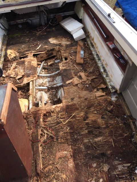

So, the next step would be start ripping it apart. The PO suggested the floor has some "soft spots". Walking around inside a bit suggested there was certainly "Soft Spots" I would soon discover that "soft Spots" in this case translate to mulch.

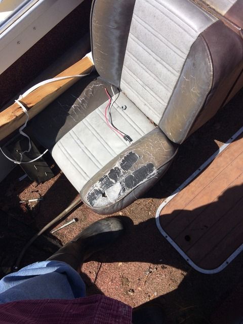

This was coupled with some great sun damage on anything vinyl.
All the leaves, pine needles, and crap vacuumed up.
Notice the nice green carpet area. There was another one under the splash well. I'm certain this wasn't factory installed green carpeting.

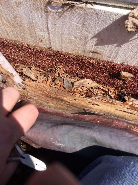

The floor was a wonder of mulch. I put the Shop Vac through a serious workout, as the floor just crumbled as I pulled up the carpet.
But, after a bit of work, and a lot of vacuum time, I am showing some results. Not bad for an afternoon of skipping out of the office.

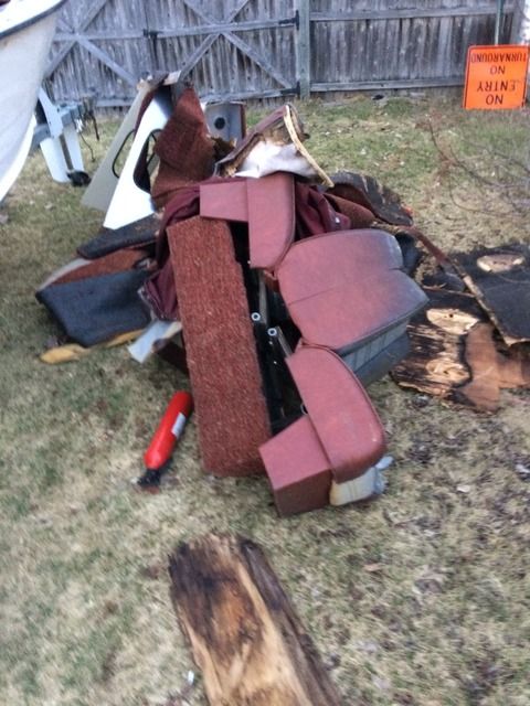

Just be careful with those consoles and bow deck support in the garbage heap.
VT Dukhntr
Sep 13, 2007
27
Waterman, the passenger console isn't going back in, driver is still in the boat. Will save that one, and may put in a low wind screen, maybe from a motorcycle or snowmobile. As well, the front bench will be a modified storage/bench, only in the bow, so the bench support as it was isn't needed. Floor plan will be pretty open to provide plenty of movement inside, for setting decoys, and picking them up. Was thinking about some storage in the front rebuilt bench, and something in the rear. Couple pedestal seat mounts for various seating options. Storage needs will be a few life vests, tools, couple anchors, and not a lot of other crap. Everything else will change with what we are hunting, or where. A cooler also makes nice dry storage, and a seat. Will keep the side shelf space, but redo the padded vinyl with something that is water proof instead. Function over fashion.

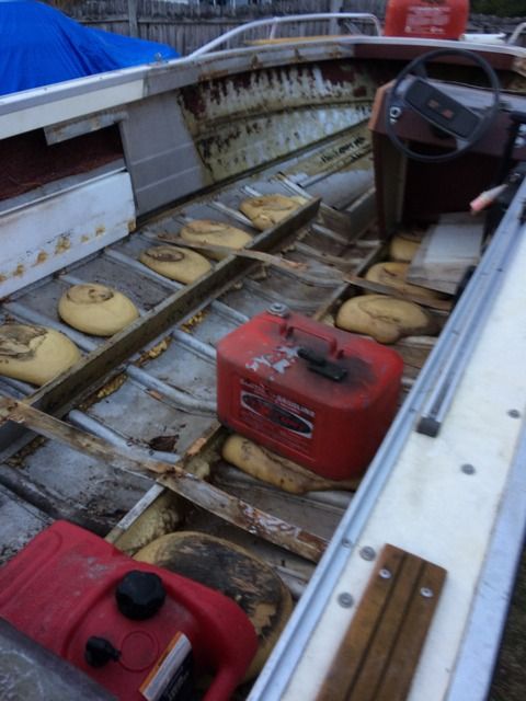

A few weeks have passed since I last posted, so I thought I would add some updates on progress.

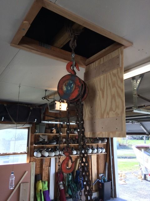

Time to remove the motor, to get at the transom
Borrowed a chain lift from a co-worker, and chained it to a 4x4 across some garage rafters

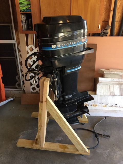

Built a stand from the plans I found on this site. Plans seemed to be missing a few measurements, but I'm creative enough to improvise. Had all the wood and set of casters laying around, so I built this quite quickly on Sunday morning.

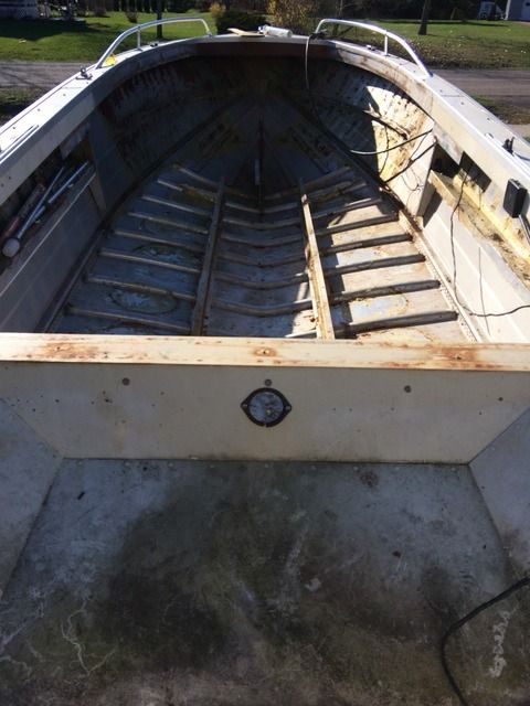

Then, moved into the yard and finished removing the little bit of floor, drivers console, and that really fun poured foam
Will get to power wash the interior, and get after the adhesive maybe this weekend.
