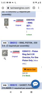

Rings are available as well as other stuff

Does not look like rings are available at the dealer ?----E-Bay likely has a vendor with some on the shelf.
