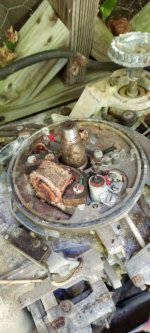

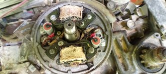

Well didn't do a lot over weekend. Removed flywheel and removed the coils and points on engine 1. Put Twc3 oil in plug holes and spun by hand a few time. Compression test top cylinder had 100psi bottom about 103 psi.
The points didn't look that bad but coils were gone.
Pulled flywheel on engine 2. Removed the coil and the points. Oil in cylinder. Spun. 103psi on top and 100psi on bottom.
Think I'm actually going to use a nova2 ignition module instead of points on these. I used one to replace the points on a eska 5hp. The 5hp would idle smoother, less RMP, and at WOT it ran great and smoother than it did with points.
