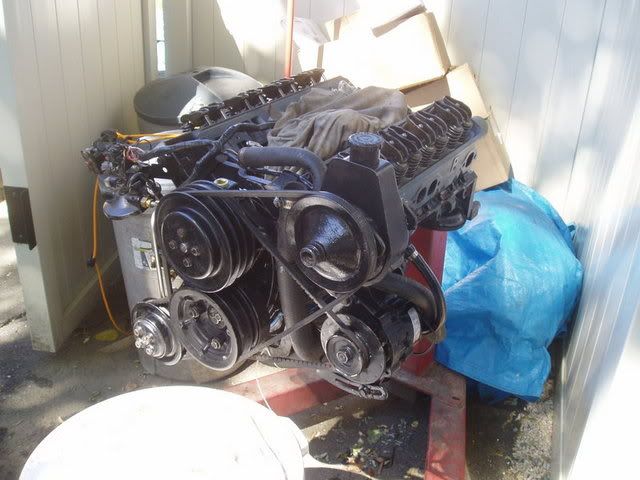

No Title
Sound the same as mine, I will attach a photo of a engine (NOT MINE) with the Alt. and P/S setup I have. , The photo does not have closed cooling ,but the brackets are the same as I have.
You can see where the problem is with attaching Sea Water pump to block with P/S adjusting bracket attaches.
Can you reply of photo of what setup you have, as I would like to see how it is. I need V-belt setup.........

merc  front view.2jpg.jpg Yeah, You have TOP mounted P/S pump. I have to use LOWER mounted pump because of width of heat exchanger, It states in SJE kit to use ONLY with lower P/S pump, but nothing about ADDING raw water pump. If I spent ALOT and purchased all new pulleys and brackets, I could Maybe go with Serp. belt..
But not in the cards right now. My engine came with SJE kit already installed. So unless I run across a deal on brackets and pulleys, I will use what I have.
I cannot find any photos of setup like mine with added water pump, All have smaller exchanger.....Mine is 25" wide........ I have another photo of WIDE exchanger setup , but not clear in photo, on setup.for added pump, I will attach. Photo., maybe someone can comment on it......

Thanks,FreeBeeTony, But your P/S pump is mounted high, I you look at the photos of the Red motor I posted is like what I have, Lower pump.
I'll find a photo somewhere.......They DID make it.
