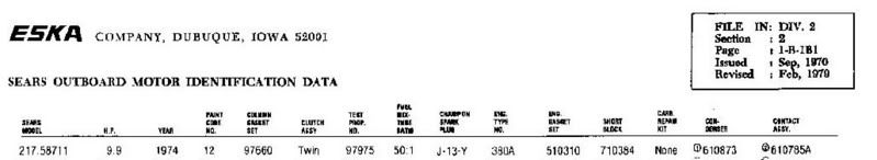

Here's the motor's info:
Sears/Eska/Ted Williams 9.9
1974
Model Number 217.58711
Engine Number 380A
