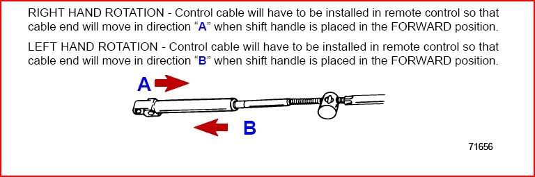

Here's a picture to illustrate the direction. A "normal" direction for your drive would be right hand, or RH:

I'm not sure if that confirms or contradicts what I wrote? :confused:
Here's a picture to illustrate the direction. A "normal" direction for your drive would be right had, or RH:
I thought he meant at the bell housing end.....
Same result, option 'A'.....:)
