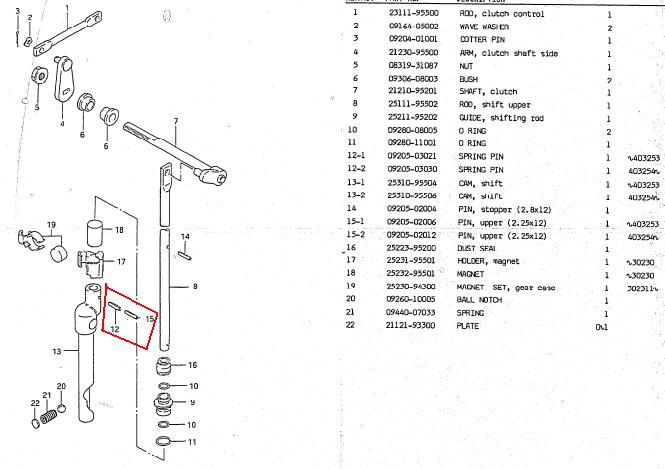

When I tryed to mount the shift cables I could see that the cables didnt fit, the shifting stroke did bottom due to wrong cable ends.
I fixed the cable ends and I thought everything was ok.
But it was impossible to get the forward gear to stay in place, and the reverse gear didnt work at all.
I dismounted the lower unit from the motor.
Then I removed the thin housing from the upper of the lower unit.
I could see that the pin's holding the upper shift rod to the shift cam was broken!
How is the pin's mounted?
Is it possible to remove the shift cam without dismount the lower unit?
I also guess I also should replace all the lower unit's seals as the seller said that there was some water in the gear housing.
What tools do I need to remove the propeller and the propeller shaft housing?
What will likely be my biggest challange if/when dismount the lower unit?
