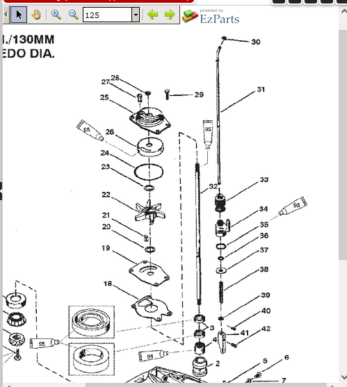

I guess I need to remove the water pump assembly again in order to pull the shift shaft? Does the assembly hold the Shift shaft retainer in place?
I'm installing the Bay Manufacturing short shaft to long extension kit. The lower rod in this picture is the shift shaft extension.

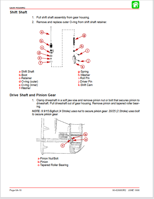

I was under the impression it slides out and back in. At least thats what I get from the 90-826883R2 JUNE 1998 manual.

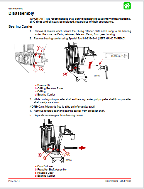

I have a PDF copy of this manual.
Page 6A-14 shows a tool to remove the bearing carrier.

I dont really think it's clear. Just says to pull the shift shaft out but doesn't outright say to pull the gears first.

flyingscott
Apr 8, 2014
8,289
#41 in your diagram is the shift cam. Against that sits a spring loaded pin and once the cam is out the pin pops out farther than it was. So putting the cam back in is a pain in the butt, it's a strong spring. That's why if you take the bearing carrier out the prop shaft moves out and also the pin. This makes room to put the shift cam back in.
