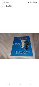

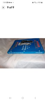

Just bought a 1997 wellcraft 190 center console it came with a 97 johnson 115 spl motor. Looking to get a shop manual. I bought this manual on ebay but don't see my model number listed in the manual. My model number is XJ115HLEUA
PIC OF MY MOTOR and the manual I bought. Will this manual be good enough for most stuff for my motor? Anyone suggest a different one that is more specific to my motor? Thanks

That is the correct manual for your motor !----It appears to be a 1998 manual.----All the same.
