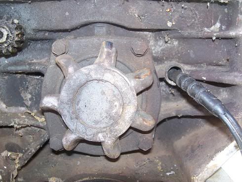

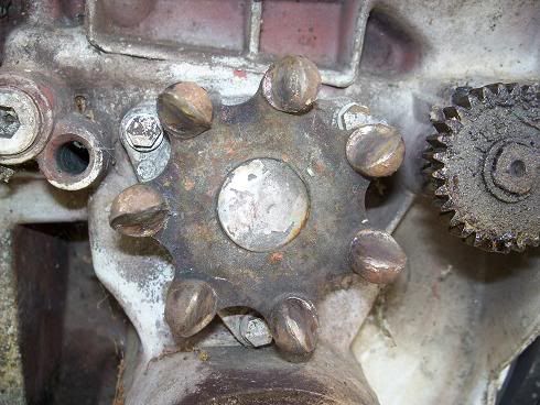

Hi, While I have the drive off the boat should I replace these two gears or are they good for awhile longer.....

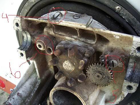

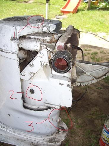

Also can someone help me identify these plugs... I believe 1-is the dipstick 2-is the drain but I don't know what 3-6 are.... Thanks all....

Replace the ball gears
1 dipstick
2 gear oil drain and fill
3 allows access to a grease fitting
4 vent, oil level
5 drain and fill
6 ??????
