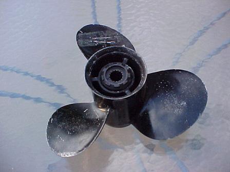

Well...Would a Picture enable you to tell me if it's a right-hand rotation? <br />
<br /><br />Anywhere I look on the Merc site...the prop selector stops around the year 2000 :( <br /><br />Thanks again, Chuck

Re: Should this prop fit my 850?
Yes, that's a RH prop.<br />It should go right on......
