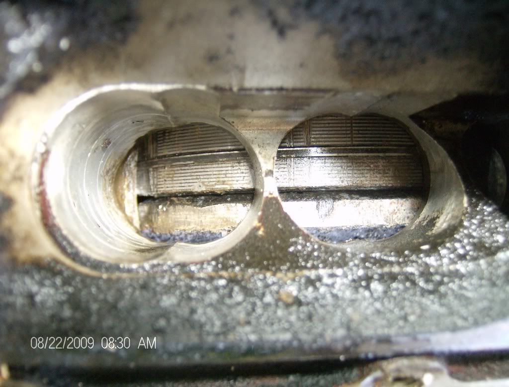

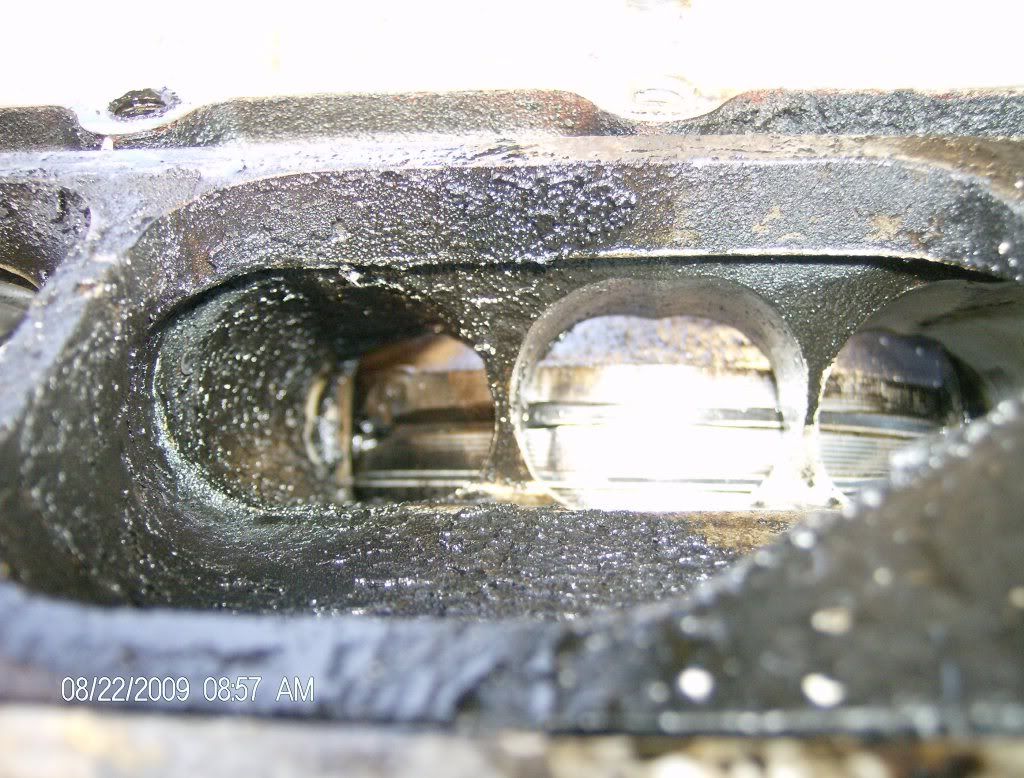

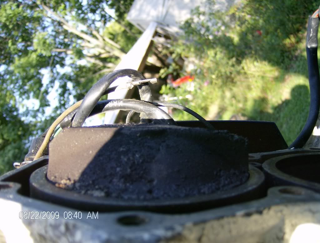

I clipped the little alignment tab and pulled the bubble back. The view through the exhaust ports told me a lot. The lower port side piston rings appear good through the exhaust port, but the top of the piston moves too freely from side to side so I suspect there is a broken ring on the intake side. The starboard side piston are another story. Serious damage to the piston tops, but the damage looks old because it is all carboned over.
The view through the starboard exhaust ports was even more depressing. Top piston compression ring has a chunk missing.
And lower piston compression ring appears to be mostly absent.
This engine has suffered some major abuse. At least 2 and probably 3 ring sets blown. What did they do to it? I suspect more damage inside also. I was able to rotate the lower starboard piston slightly in the cylinder and there was a noticable clunking when I did (wristpin/rod?).
The Cylinders themselves look not bad and the headgaskets look new (no carbon deposits). Looks like someone replaced the headgaskets after the rings blew on the starboard side. Maybe the headgasket blowing on the port side is what finally stopped it.
I wish I knew what happened to this motor. I guess it doesn't matter because it is probably beyond repair. Has anyone seen carnage like this before?

I agree with KenM. The damage you are seeing is not unusual for the crossflow family. Even though it looks dire, I would not give up on it yet. Pull the block down and inspect it thoroughly. If a rod went through the side or if the block is cracked in the port area-then it would be scrap. If The block is solid and borable-it is rebuildable. Check out replacement parts pricing and honing or boring costs, then check out pricing on a new engine or a replacement engine. Then decide.
