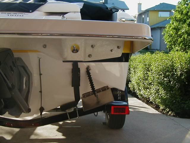

Installed my Smart Tabs 1290-80 on my 2006 Regal 1900, with placement advice from John here , Thanks install no problem ....hope to get in water this weekend for a test <br /><br />pics <br />

Results on Smart Tab Install ...still using stock 21 alum prop ...... hole shot was not as good as expected almost zero bow rise but still not what I looking for .pbly need a 4 blade 20p prop but I need to adjust the tabs to full downforce and retry ..but handling in rough water at high speed was improved and my top speed went up 2mph ......so more fine tuning <br /><br />One thing that no here has mentioned after a Smart Tab install ......at skiing and tubing speeds alot of extra spray coming off the back of the boat for short line skiers can be a problem ........hoepfully playing with adjustment of tabs will reduce the spray

Ok checked my Smart Tab install ......both were set at more than 25* I guess I was not fussy enough when using the cardboard template ......checked with angle gauge and readjuted to 25* also reset pressure to the softest position .......... NOW we have a decent holeshot ...just a slight bowrise and nice steady acceleration I evewn think starting with trim up slightly is a sgood or maybe even better .......top speed did not go up because my stock 21P 3 blade prop now blows out before the redline
Tried PowerTech 20P MQS 4 blade ....ski version with no cup ......again improved holeshot but the 20P blows out as well at high trim also WOT rpm 200 below the 21 3 blade alum
Powetech sending me 18P 4 blade SFS cupped and ported .....this is a very tough prop to turn so lower pitch will help and dont expect it will be much over redline since its cupped and will grip the water at high trim
