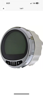

79-8M0135536 NMEA 2000 Data Level 1 Kit SmartCraft MercMonitor - No NMEA 2000 Data
This is the description of what we ordered with part number. I will attach pic of the gauge itself.

The gauge also came with its own harness part number on that is 84-8M0055076. It plugs into the instrument and has some other connections on it as well. It would not plug into the original engine harness however. So I got a male to male connector to go from the engine harness to the gauge harness. No dice. If I plug the gauge and it’s harness directly into the engine(plug next to the 14 pin harness connector round plug) it comes on and works fine.
