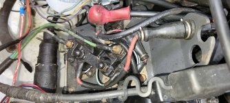

Ok, got the picture of the solenoids. i was able to find a picture of an assembly and the wiring seems to be the same, so not sure why that fuse blew nd not sure why I no longer have power to the dash.

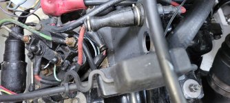

I took some pictures of my setup, hopefully it helps. I have the 2.3 liter Ford but I'm hopeful you or someone else may see something.

The large black wire that is connected to the where the red fuse wire is looks like a ground wire. That may be what is causing the fuse to burn out.
