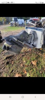

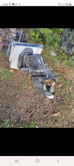

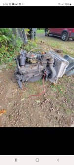

Can I get opinions on this, please? The motor was just sold

Get the info from the model tag and check the final ratio to make sure it's close to what's your ratio is.
It took me probably 5 years of classifieds to find my drive. I converted from an electric shift to a mechanical shift on my stringer.
IIRC my electric ratio was 1.51 and the other was 1.49 so really close , which is why I pulled the trigger on it.
If the ratios are too far off, you will to change props to compensate

If the info I found is correct, I have a 21:21 ratio. My next question is being a 1988 model. How crucial is it to find exact model and serial numbers? I've read about various opinions.
I took a screen shot on my phone, but it gives a security error, so I'll have to go on PC to get a pic to demonstrate.
I apologize for all of the rambling questions but just like my first noob fiberglass boat build I am learning about outdrives 😊

It’s most important to get the correct drive ratio for your engine and, from 86-89 the 4 cyl models used a smaller lower unit; the 90-90 all used the same V6/V8 lower unit. So you can use a 90-93 on an 88 boat as long as your overall gear ratio is right for your engine, and get a stronger lower unit at the same time.
Lou C
Nov 10, 2002
13,045
lol yep, missed that. Well the one in the pix is from a 3.0 seeing as how the engine is right there, and here are the gear ratios from my old OMC manuals:
2.3 liter Ford: 2:1 overall, upper 21:21, lower 13:26
3.0 liter GM: 1.71:1 overall, upper 21:18, lower 13:26
so the question really is, would you be able to compensate for the taller gear ratio of the 3.0 drive, by changing props to make it work with the 2.3? That, I can't say for sure.

Thank you. Because of this, I am going to keep an eye out for a V6 lower unit; I like things stronger!
