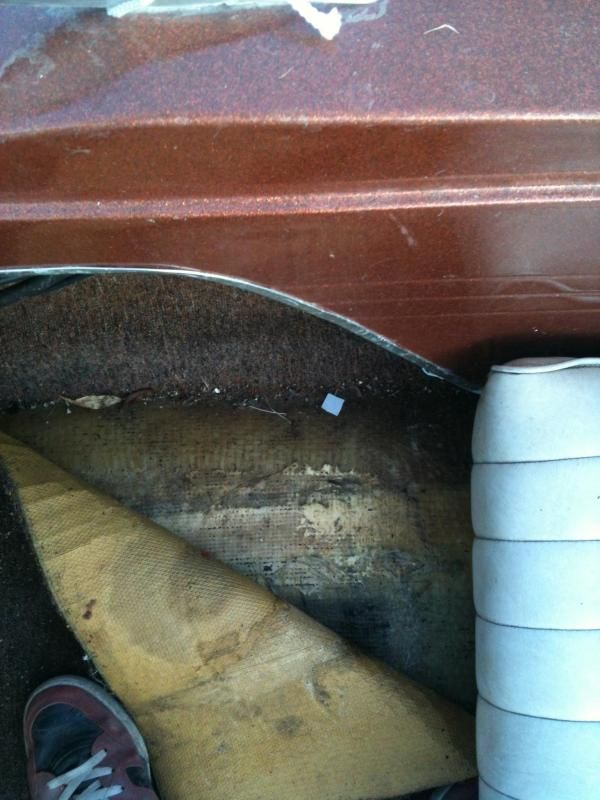

Today I found a loose bit of carpet and was going to stick it down. I peeled it back and realized there is NO wood underneath...just a load of fiberglass, I carried on pulling back and no wood anywhere!
Should I worry?
Im paranoid someone has just ripped the wood out and put the carpets down? is this a possibility? Not really sure what to do...

I have one here, but can get more if necessary is that any good? :

Hard to tell definitively, but it looks normal from this distance...
The wood should be underneath the fiberglass...
You could drill a shallow hole, maybe 3-5mm, into the fiberglass and see what behind it...if all is well, you can seal up the hole with a dab of epoxy or marine sealant...
Do you feel any give or flex to the deck when you walk around on it?
