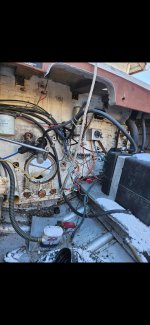

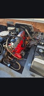

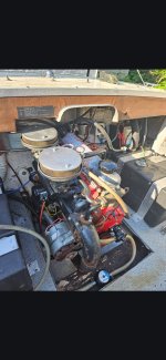

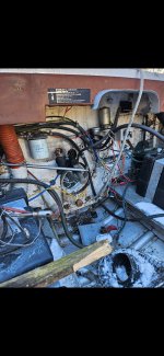

Currently the boat has a Volvo B20 with Aquamatic 100 stern drive. The magical fact here is that it appears the motor weight is placed on the transom via the transom shield and flywheel cover. Yes!!!! No engine mounts and this has been the setup on this boat from day 1. The transom takes the full load of power and its not transferred to engine mounts
Most forums state that an i/o transom setup was not meant for an outboard to sit on the transom. The engine power distribution shifts the weights to the engine mounts and stringers. I would agree that slapping an outboard on would severely impact a transom for one not designed for the power being against the transom.
In my case. No engine mounts and the power being transferred by the stern drive right to the transom, does this signify that I can fill the keyhole properly and install a single offshore bracket to the transom with perhaps some transom reinforcements and get away with a pod on the rear of the boat?
See attached pictures of the engine when I received the boat for a better understanding. Trying to get away with this project without extensive costs but also doing it properly.

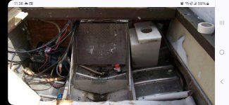

Replace the transom wood with something more heavy duty and add some supports to those stringers which appear to be aluminum. Should not be hard to Fab some nice HD gussets to go from stringers up the transom. Then add your pod or other mount for an outboard. Replace the exterior plate with one that helps support the new motor mount. I would go with a nice two stroke to match the period of the boat. Don't see an issue if your fab skills are good...
