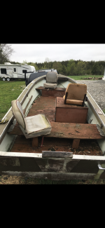

Ok here we go. Just started today.
Is there any sealant I can use on the inside seams and rivets? Or is that a waste of time?
Ready for a leak test.

Paging Dr. @BWR1953 to the drydock, STAT!
gluvit or coat-it for sealing rivets & seams
BWR did a great job on his Kingfisher and documentation posted in his rebuild topic is well populated w pix & descriptions

For my KF, I did the leak test and then we rebucked every loose rivet. After that, I used Gluvit. I was lucky that I didn't have to replace any rivets on my KF though. Not like the Chieftain that I'm currently working on. 😏
The nice thing about stripping the boat down completely is that it's a blank slate and you can configure it any way that you want.
I'll be following along! (y) :cool:

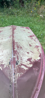

I did a leak test. 150 drops per minute out of the seams. Where the bottom meets the sides. Both sides.
Rebuck 500 rivets or just Seam seal?

We rebucked 300+ rivets, then leak checked again. It passed, so I then did the Gluvit. When finished, we had zero leaks and the hull has remained completely dry since then.

I’m going to seal the seams with coat it. Inside and out. No rebucking the rivets. Because the rivets aren’t leaking the seam is. Someone already put a sealer on the rivet heads and it would be difficult to remove. I know rebucking might stop the leaks but they aren’t leaking so they are probably tight. It must be a failure of the factory seam sealer.
If it leaks in the future I’ll have to fix it from the outside.

The most common area for leaks is the keel plate as it takes the brunt of all the landings and is out front for whatever may come it's way. It's somewhat difficult to seal up properly so take you time in preparing the surfaces removing any crud or loose red smeg. leave the stuff that's stuck good.. Besides the coat it on the inside, some will add 5200 on the outside edges of the keel plate as well for added insurance.

It’s leaking about five drops a minute at the front keel. I guess I’ll coat it on the inside.
Biggest thing is to be able to fix any future leaks from the outside because once i put the floor in I might never take it out. I might use spray foam because I’d like how solid the floor would be.
