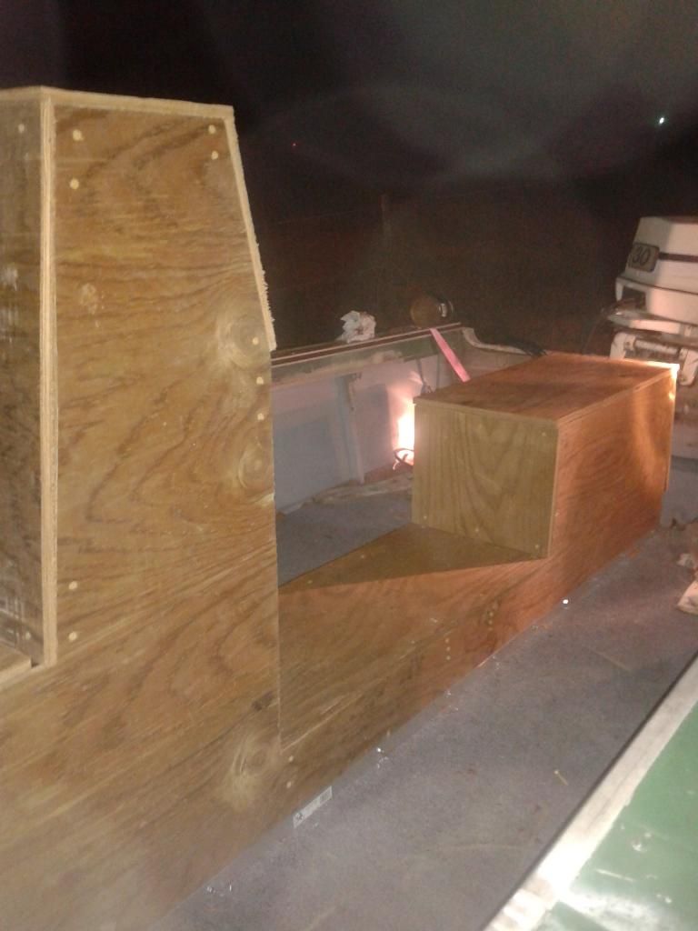

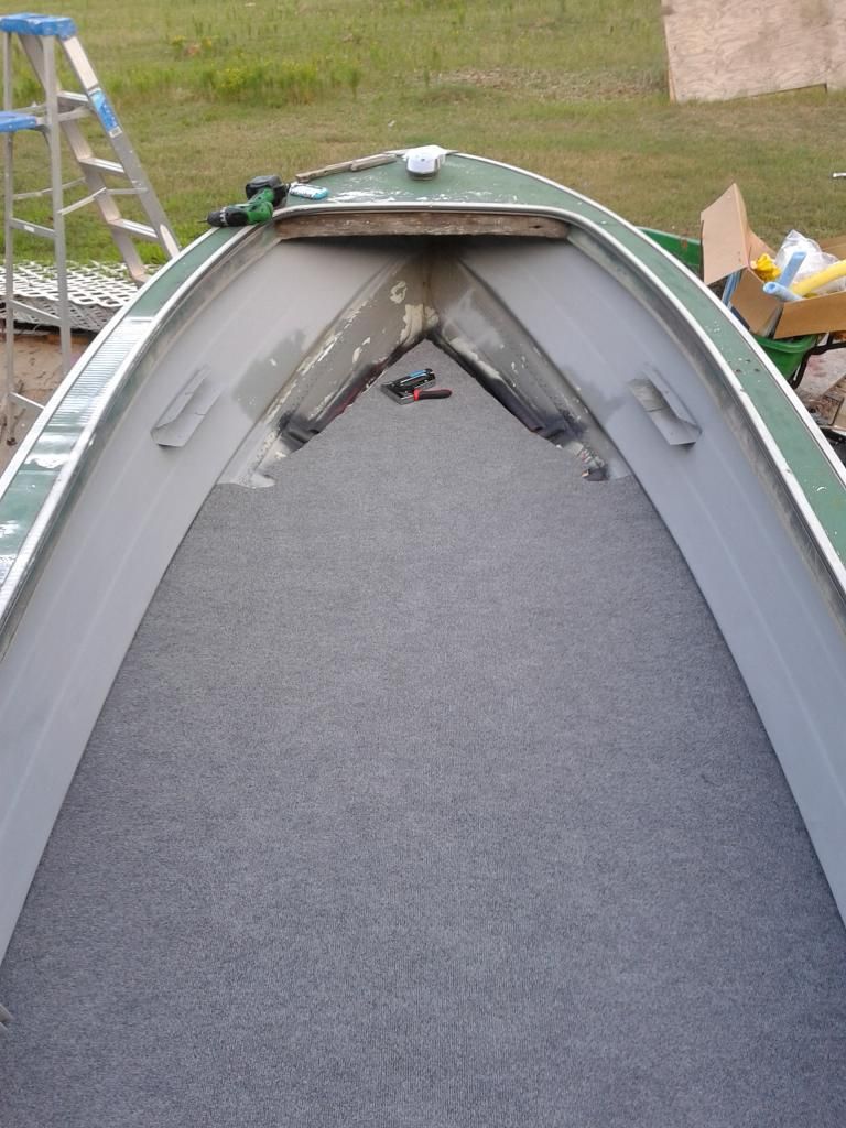

This was my grandpas boat and the boat my dad grew up using and me when i was younger. About 17 years ago the transom got to rotten to use so we parked it in the back field and left it. So About 6 years ago i decided to restore it or try to. I completely gutted it and replaced the transom and just lost interest at that time. Well this past spring i really got back into restoring her and i have put a floor in put carpet down built the console rebuilt carb for the motor bought used controls for the motor installed them and put new steering cable in. We had a friend of ours give us a old bass boat they didnt want anymore so i used a lot of parts off that boat like the steering cable. the old bass boat come with a 86 evinrude 120hp that i need to put on something lol not to bad to be free lol. anyway here are some pics of the process let me know what yall think still have to make platform for the front and carpet it. then paint the boat later on sometime not in a huge rush since this is going to be a fishing boat! click on the link to look at the pics. for some reason it wouldnt let me attach any. Go ahead and let everyone know since i have had other people tell me about pressure treated plywood on aluminum, yes it is pressure treated wood when i bought the wood i didnt know i wasn't suppose to use it but it was to late then so i did some research and i let it dry out outside for 2 months and sprayed bedliner spray on the aluminum where the wood would come into contact with the boat but im going to keep a eye on it! http://s1113.photobucket.com/user/anthonyjjjohnson/slideshow/boat

  • to echo what the other guys said...(and as I guy restoring a badly corroded vessel)...you should consider removing the PT plywood entirely.
  • Add a splashwell...treks have a narrower beam and more draft...plus it adds a lot of support to the hull; you'll experience less twist.
  • Was the forward bench added back? Our boats like to get floppy when pieces get removed. And when they get flopping, they crack-up...literally! :eek:

Lost the splashwell need to try to find it, it may be around here some where I'm still not done with the boat yet but instead of a bench seat we use to have a platform there I'm going to replace it. Setting that the boat was free and I don't have the resources to replace all the wood I'm going to leave it inand see how it goes since I put a barrier between the aluminum and wood. But I do need to try to find splashwell
