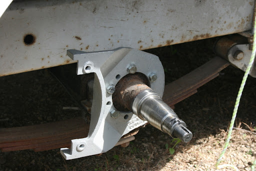

Started my disk brake electric/hydrulic upgrade
lime4x4
Apr 25, 2007
1,040
Finally started to replace the drum surge brakes on my trailer with kodiak disk and brakerite-II electric/hydrulic. Total cost around 1500.00

I did it for my own personal comfort. I trailer the boat to chesapeake bay a few times a year. It's about 140 miles one way. My boat and trailer weigh in at 9200 lbs. You know it's back there esp when going down hills. The surge activated drums just were't cutting it. It would be nice to be able to push a button and have just the trailer brakes apply when necc. Plus having the disk should help with stopping power when some idiot decides there going to pull out in front of me then slow down. i got a digital in cab brake controller that has a setting for electric over hydrulics.

Just an update. After installing the system and working out the kinks. It was money well spent. When needed i can stop on the dime just using the trailer brakes if i had to. I also have a single axle surge/drum setup for my other boat. Next year that's going to be converted as well. I'm a firm believer in a E/H setup
