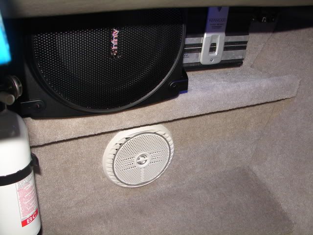

here some pics of mine, here you can see a similar idea as what I am proposing to you build a box under the helm facing the stern, in this case ignore the 10" sub and amp focus on the 6 1/2 infinity Kappa, this is a box fabbed up and carpeted

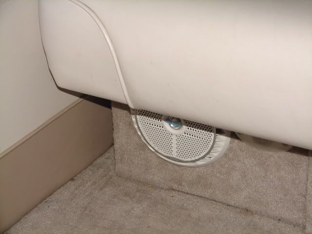

and here you can see under my lounge another Kappa this is in the same position as what I am proposing in the rear of your facing forward(the bow) same idea as SCCA
you can build a box or a panel its all up to you, the best part of it is that you build it for 1/4 the price of someone else doing it, and then you wonder why anyone pays someone to do something this simple, you don't have to go as elaborate as me or SCCA have right now but once you get into it you will be amazed that its this easy, you can simply build an 8" box with a properly sized hole for your speaker and another very small hole for the speaker wire, use wood glue to seal it and screws or nails to keep the box fixed until the glue sets, spray the entire outside with spray adhesive and carpet the box, place the box in its location in the boat and screw it from inside the speaker box to the floor. Attach the speaker wire to the speaker and screw the speaker in place and your done, repeat on the other speakers. you don't have to wait for anything to set up go from one process to the other until its complete. if your doing panels get some scrap cardboard from some companies trash, use a box cutter to cut the shape of the panel and then trace the shape onto marine plywood and cut, then spray adhesive, carpet and if say your attaching it to a gunwhale use screws to go from behind, through the gunwhale into the panel, then use stainless L brackets from Lowes or Home depot to mount to the floor you can do your whole boat in a weekend or two. if you want to do vinyl well thats a little tougher if you want more then one color but all you add is a foam backing in between the plywood and the vinyl.
