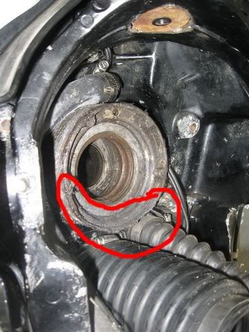

The bottom of the bellows mounting flange on your transom shield appears to be corroded away pretty badly, as you can see inside the red circled area in your pic below. It's a pretty common problem if your bellows has been leaking, or the little "galvanic corrosion prevention" clip isn't on it.
Could be where your water is getting in if the bellows can't make a good seal. I've heard of a kit to repair them, never used it myself. Here it is:
http://www.ghrkits.com/index.html
Might be something to think about.
