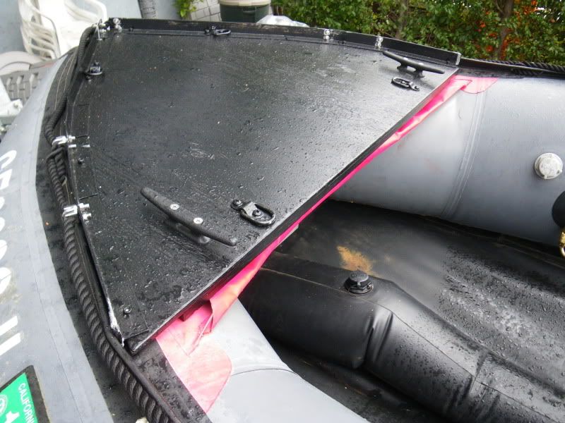

Is your boat set up with a tiller or remote steering with a console?
My boat has a tiller and with my weight and the engine at the back, I try to get as much other gear (fuel, anchor, dive gear etc.) up front as possible. I made a bow board where I stow all the safety/emergency gear in a duffel bag to get it off the deck. I'm sure you could mount some kind of rack for your surfboards on a board like this.
