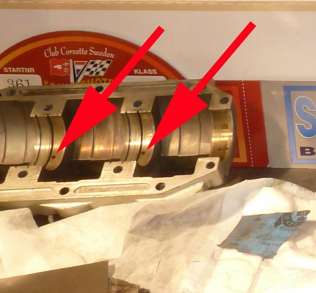

Crankshaft installation in to the block:
When reading the outboard shop manual; it should be a small cutout f?r the bearing locating pin's in the cylinder block.
I couldnt find any cutout in the block.
In the crankcase cover there is a hole but it doesnt fit!!
The only position I could find for the bearing locating pin's was a small milled pocket inside the block (directly under the piston's)
I only had a couple of minutes before the bond was hardening so I assembled the block and crankcase cover.
But after, I asked myself was this really right??
Did I miss something....?
Bearing locating pin on crank:
Holes in crank case that doesnt fit:
