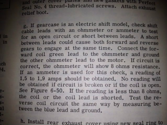

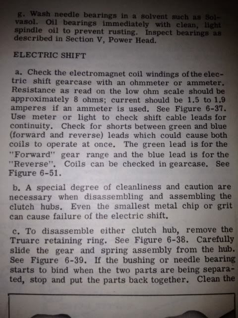

This is from my service manual....

Are you trying to attempt to shift the gears .while the LU is off. I don't own an electramatic(mine is a manual shift), but my service manual covers both.
Not sure if you can shift gears while motor is off....on manual motors you can't(or aren't supposed to) attempt to shift gears while motor is off. I don't know if this is the same for electric shift motors.
Do what the manual says. If it tests out well then you're probably good to go. If you have problems shifting once the motor running then you probably have issues with the gears inside the case.
