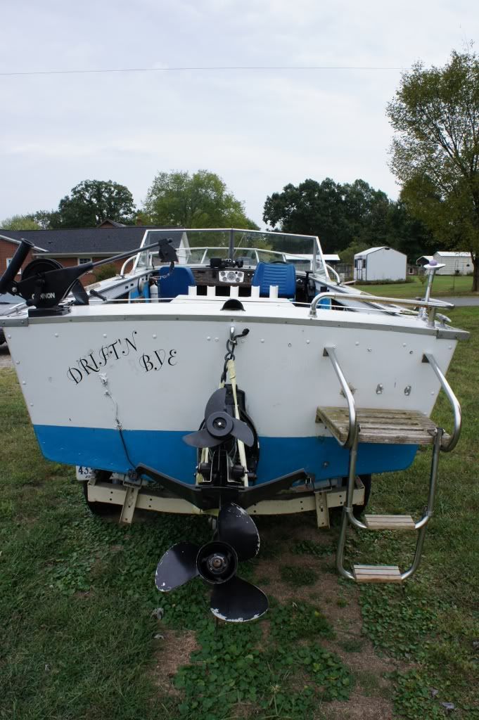

Below are images of the boat...Dash, Outdrive, etc

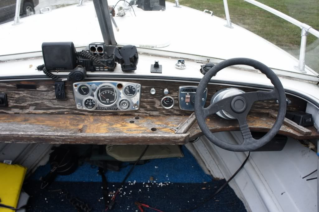

Dash

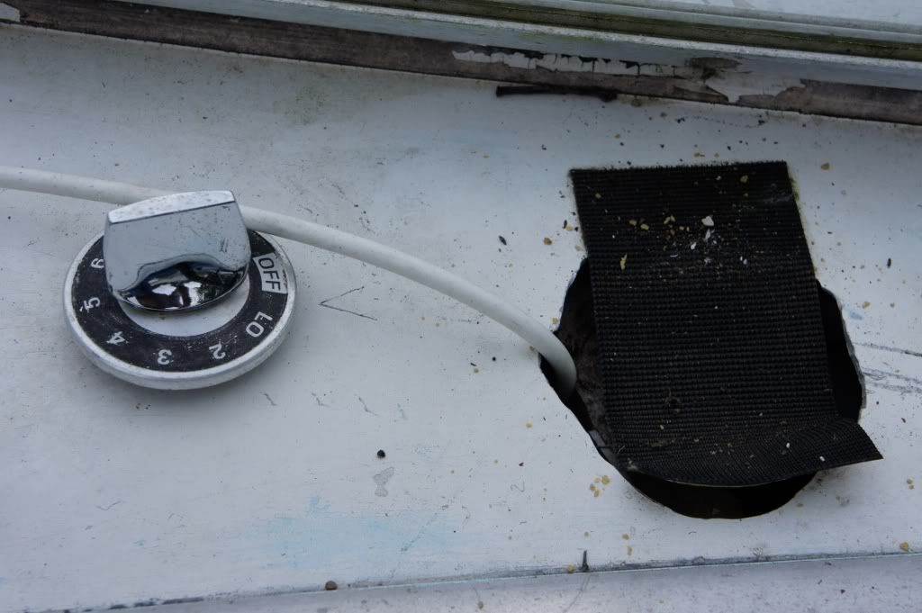

Dash close up..YEP!!! an oven knob used for the trollin motor(as seen below)
Its like a turbine :cool:

Nice rig and welcome to the Starcraft brohood! Man that oven knob is classic:D

Thanks jaoutside! the knob is hilarious it controlled the trolling motor mounted on the back.

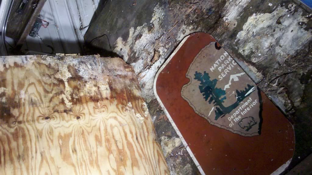

Can anyone beat this? found anything better on there resto project?? IM thinkin you might be a redneck if you cut a state park sign in half to use as a floor support on top of the rotten one..
Thats probably a federal offense, might want to hide your address! Haha

I appreciate both of your replies, I decided today that the wood would not only be expensive it would be way to heavy! I bought some teak for my dash today and itis just way to heavy. I found teak veneer for a good price and may try it to see if it looks good. The manufacturer told me it is used in marine application and as long as I seal it with marine spar varnish it will last a very long time(assuming it is kept covered and not left outside its entire life. We'll see how it looks tomorrow.
ALSO does anyone know if the dash in the picture is the original style? I am hoping to replace it Saturday and would like to keep as much original as I can.
Thanks again for any advice
You say teak veneer? Yes it is used in marine applications but it is installed usually by contact adhesives just like most laminates. You will be working with very thin material that if you do not know how to manufacturer it properly it is easy to screw up. Also veneers are usually used for interior use, not exterior. Exteriors of boats get moisture constantly. Not just from rain, wave splashing etc. But also from condensation. laminates are exactly that, laminates. The wood under the laminates is the problem. If this substrate gets wet at all through the seams of laminate it will cause the laminates over time to delaminate. Also sharp edges are a concern with most laminates. Now, if you are talking about solid surface plastics, like corian, starboard etc. They can be formed to anything you desire. What thickness teak did you buy for your dash and why do you think it is to heavy? Take a look at my rebuild thread, I am in the process of spar finishing all the teak on the boat. Once done it should be good to go for many years. Each season or two, I will lightly sand the finished teak and add a new coat of spar varnish.
There are ways of building dashes to keep the weight down using wood. Wood will not be any heavier than a laminate with a wood structure under it. The main concern when mounting teak or any other wood to aluminum is the difference in expansion and contraction. You need to locate the fasteners where they will not split the wood.
