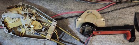

Hey thanks, is anyone familiar with the Neutral button component(s) for this unit- i 'haven't been able to locate any. Thanks.
It's an 818513-C and here are some pictures.
The controller works well-enough, but without the Neutral button components, there is no way to rev in neutral. Thanks

Thanks. Looking at the module schematic, it looks like there are some parts missing from the module itself (maybe 27, 28, 28A) or more (or no)? And then looking at the "remote control assembly schematic" it looks like some parts are missing: cap/button (#24) that clips over (not the standard "dip-stick looking type of button) and also #8, 9 and 25. 'Looks like the issues is that parts are no longer available and I'm not sure exactly what I need anyway. Unless I find a matching used controller and could piece things together -I'm stuck. But, at least I think i know what is missing. 'Maybe just replace the whole unit...but with what exactly. The cables are gen one, so they might have to be replaced. Any "for sure" solutions would be appreciated. Thanks again for the direction: attached is the schematic that matches my unit.

The ends on the shift plate end remain the same, only the bennacle end may have changed.
I would suggest calling Merc Tech support with your motor serial number and model number from the binnacle. They can advise which ones/types will work
920-929-5040
