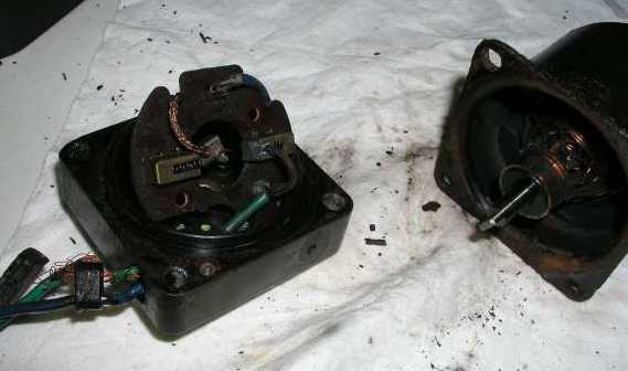

Thanks guys.<br /><br />lark, I had to disassemble it, because the cable was broken so near to the housing and additionally, it did not work even after I tried to get a better electrical connection.<br /><br />Heres the picture. See the broken cable.<br />
<br /><br />So I got the motor out, broke it in parts.I drilled both cables out to get new holes into the lower housing and then I found that the right brush was stuck (and is quite rough to the contact point)<br /><br />
<br /><br />I cleaned it, got rid of some debris and its now moving smoothly. (although I wonder if I have to sand the rough round surface ??)<br /><br />In addition, I would like to clean this little switch inside, as those contacts dont look to good either.<br />
<br /><br />But maybe it would be better to replace it.<br /><br />Does anybody has a partnumber and resource for this guy ?<br />
<br /><br />It's not in the Seloc manual. The OMC manual states it's a Fas Trak something.<br /><br />Thanks for the tips on getting the brushes in to all others.
