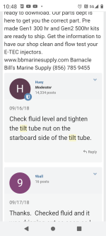

My E-tec did it and this was all over e-nation at the time. Tightening the not made mine go away. Barnacle bill has much to offer in advice for the guy.

When my 115 E-tec....did it, it was going on for a year and I thought it was my bushings for sure but I read that at the E-tec site and bingo it fixed it.
