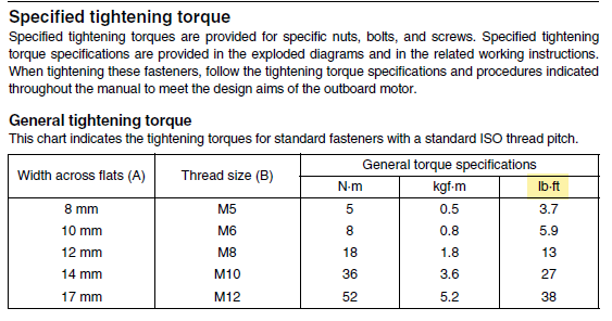

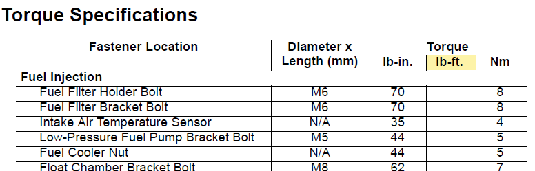

Torque is expressed in pound feet. Not foot pounds.
Many get it backwards.
