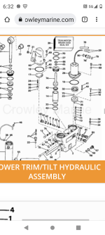

I guess I don't know that outboard. 112? I see now on your parts breakdown. One thing that other did was open the relief valve. Did you do that? That will make it so you can lower the ram creating more room.
I've done a couple and usually it salt damage but they don't wiggle.

I was worried that the relief valve was catching, so I took the entire thing out.. same result.. What is item # 56 in the diagram? Is that maybe another pin that needs to come out?
