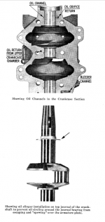

see info on slinger on a CD
  • Slinger example.pdf

Great information here! I wasn't looking forward to replacing a top crankshaft seal and now I have a complete understanding of the slinger and bearing lubrication surfaces. Thank you for the documents!!

info is from the Johnson manual which you should get a copy to service your oldy (oldies)
