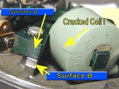

Align the coils so that the coil base aligns flush with the coil mounting bases on the armature plate. Make surface A flush with surface B.
