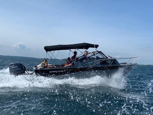

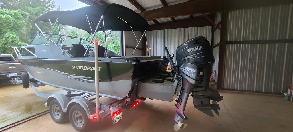

Right, the I/O engine (450 lbs or so) is forward of the transom, the transom mount and outdrive probably weigh about 120 lbs. I'd say that you might need a longer trailer to get the tongue weight where it should be. Even though the OB is lighter, it is cantilevered off the rear of the transom especially if it is installed like the boat in the pix with the bracket, that pushes the weight far back, the I/O actually has superior balance.
