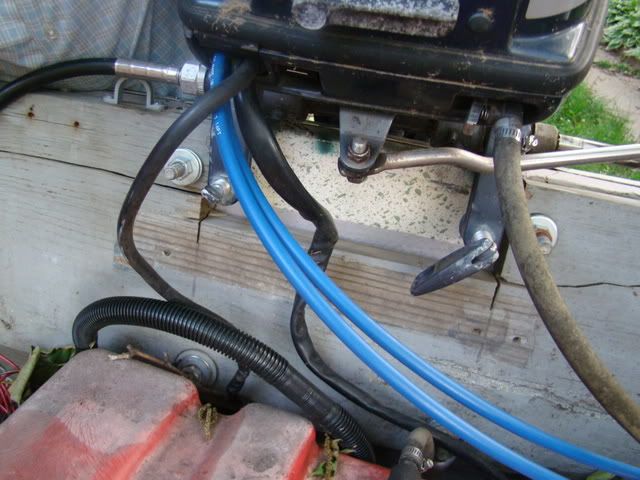

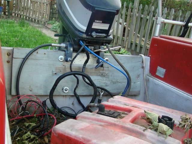

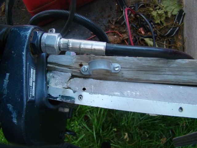

I have a 1972 Fiberglass sixteen foot Deck Boat with a 55 HP 2 stroke Yamaha. The transom is rotted and has been patched with a 2 x 12 or 2 x 14. The 2 X is cracked. I don't know how old the 2 X is. Running the OB the transom flexes. I'm looking at replacing the 2 X. I AM NOT going to tear down the transom at this point in time and redo the whole thing.* My question is: Use another 2 X or use two layers of 3/4" plywood?
The 2 X was cut out around the top OB mount clamps. I figure I won't cut out mine, just route/sand down the thickness so I can fit the patch under the clamps. I'm also thinking about routing the top of the back of the patch so I can put a piece of angle iron (bed rail) along the top as a reinforcement.

I TOTALLY understand your situation, but...doing what you are proposing is NOT SAFE and will NOT fix the Problem!!! The stresses and loads put on the transom by the motor and waves and wakes could actually rip the motor and transom off the boat which would SINK the boat. It has Happened. Not what you want to hear, but it is the truth. Post some pics of the back of the boat from the outside and some others from the inside but farther back so we can get a wider view. What Make is it?

Looking a the pic's on yours it looks as if the transom has already given away. It also looks like it is curved instead of straight. It looks like there is not enough good wood to patch too. In MHO I would never take my wife out on the lake in a boat with that kind of damage.
You should really fix this problem before someone gets hurt or the transom fall off and your motor with it.
Good luck with what ever you do. But do it right.
