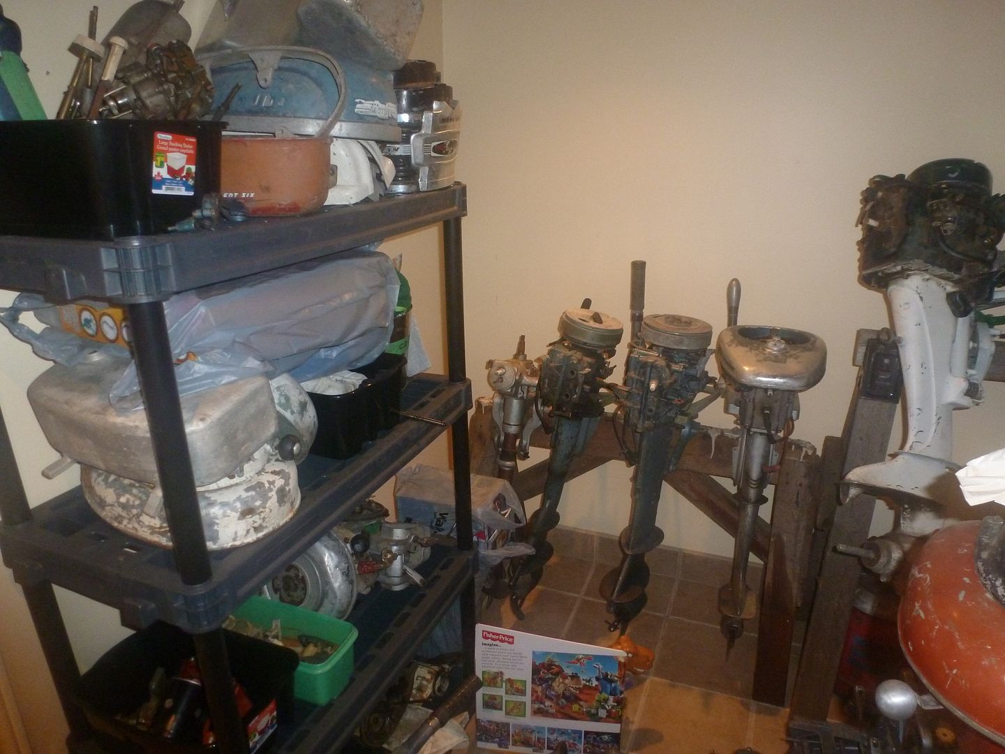

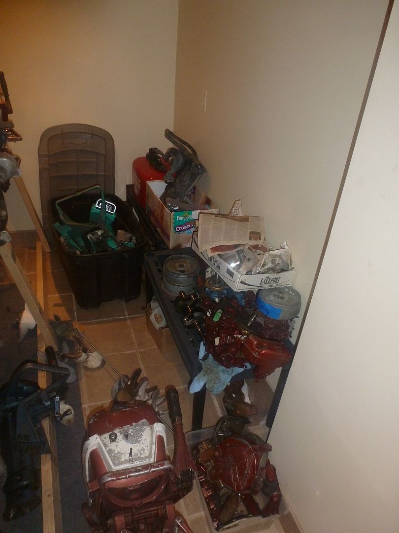

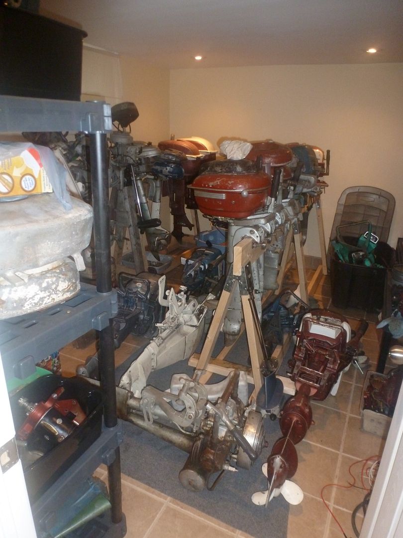

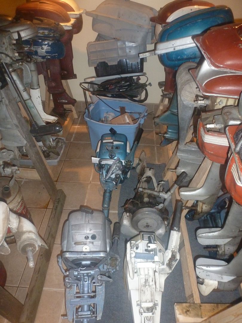

The trick is to completely bombard them initially, then cut down to only a couple rooms, and they're happy.
I pretty much have the whole basement filled with motors. 2 parts rooms and 3 rooms full of good motors to work on over the winter.
As long as I leave her a path to the washer and dryer she doesnt complain anymore. She tried but I think I won and she gave up ;)

lol....sounds like you made her THINK she won ! :washing:

HT - Looks awesome, but if I did that my house would be my own and there wouldn't be anyone to do laundry, cook....... That and I'd be paying alimony for the other house that my wife and kids were living in.

Showed my wife pictures of your collection, and she no longer feels that my affliction is as serious as once it was. Thank you for putting it into perspective for her. She is concerned, however, that my present collection could grow into a similar situation to yours.
I think she referred to you as a "boat motor missionary..." Out there trying to save lost souls, I suppose....:rolleyes:

next on Hoarders... the man with a million motors :)

And I thought my wife's shoe obsession was bad....do they just appear at the front door during the night with a note attached as they do at Zephy's?
