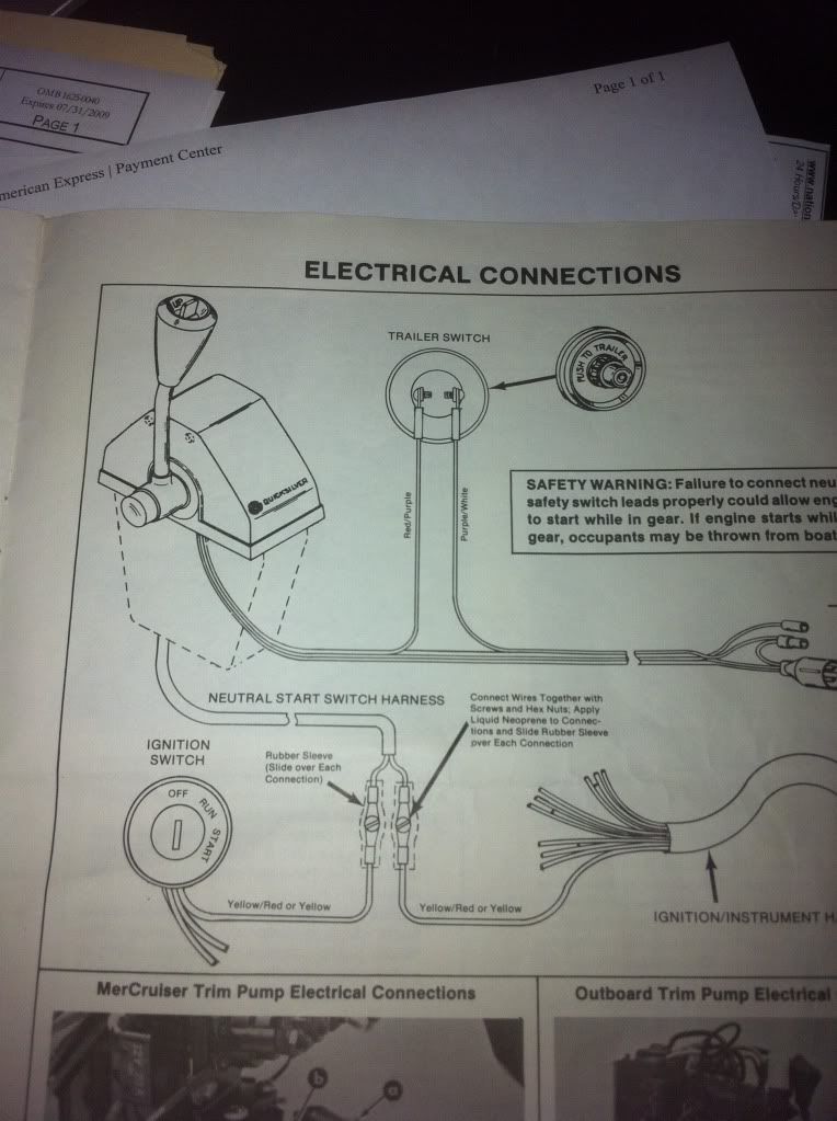

Here are the pics from my manual that I have. I also confirmed that the switch is bad because i was able to remove it from the lever and bend these tiny clips out to open it. Inside is a very simple switch but one side was completely rotted and had no copper to make connection. Also I jumped each wire and up and down works when I jump it. Problem is I cannot find this switch anywere.
