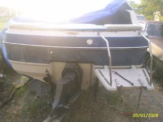

I have a 1988 bayliner capri cuddy 1952.She has a 305 omc cobra.Runs great pulls on plane fast.The problem Im having is water coming in the vent holes.This only happens when hard acceleration or pulling tube or skier.I know for a fact she isnt water logged.Rebuilt with no foam and drains running back to the bilge.It has a 14 1/2 19 prop and tacs out at 5200 speedometer shows 50 to 55 depending on water being run on.Will a hydrofoil or trim tabs work to keep back end out of water?

unscrew and turn them around.
looks like spray should slide over then.
maybe hydrofoil on the lower unit?

you are stern heavy to begin with, put a set of smart tabs on it, to get the tail up.

I think my swim ladder will be in the way of a set of smart tabs.What about a hydrofoil or whale tale?

I went with a stingray.Will post back what happens as soon as its in the water

Went with a stingray on the outdrive the less intrusive first.Works as stated I love it.Now I got an esa switch sticking.Fix one break two.

I think he's right, look at Red Ones boat, his are different.

it looks like they are acting more as water scoops then blower vents. I still say they are too low, but not much that can be done about that. It should only be those 6 screws on each to turn em around.
