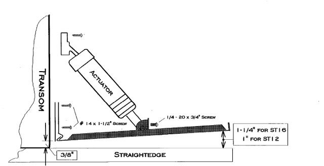

Boatist is spot on in regards to the benefits of Helm Controlled Trim Tabs. I would like to point out that if Trim Tabs are installed with the proper amount of negative angle when fully retracted they should not scrub any speed off the top end and not hold the bow down when not in use. Negative angle is the amount the Trim Tab is angled above the bottom of the hull when retracted. Additionally on some of our Trim Tabs designed for faster boats the we call for the leading edge where the Trim Plane is attached to the transom to be mounted slightly above the bottom of the hull. Combined with the proper negative angle this allows the Trim Plane to ride above the water flow when the boat is planing, thus creating no lift when retracted.
In some instances where this is occurring we can help the boat owner modify the stroke of the actuators so that they retract further, increasing the negative angle, raise the Trim Planes above the water flow so they are not affecting the boat's trim when fully retracted.

OK, let's think about Trim Tabs like flaps on an aircraft. Flaps are used to create more lift on takeoff and retracted to reduce drag at higher speeds. Trim Tabs accomplish the same thing and opposed to a hydrofoil are not always causing drag.
Also a hydrofoil is "coupled" to the motor's trim and changing the trim for best speed can affect trim when using a hydrofoil. Trim Tabs allow you to trim the hull's attitude when needed and the power trim is used for trimming the propeller for maximum efficiency.
I'll admit I'm biased, but having spend many years working with Trim Tabs and boat owners I know that they are the most effective way to pop a boat on plane faster. I agree that getting the right prop on the boat is key, but if you take a look at Flat's Fishing Boats (the gurus of skinny water hole shots) you will find that virtually every one of them is fitted with Trim Tabs.
